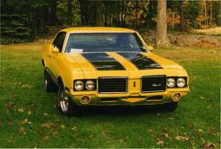

Don love that your Son is using an Olds engine!!!!! I'm an Oldsmobile guy and have been for a long time. I've rebuilt a few Olds engines. LOL My first car was a 72 Cutlass (the yellow one in the pictures below). Here's some pictures of my collection. The Gold 69 has a 455 also bored to 468 and it has a Muncie M22 4spd behind it. The Green 68 is bone stock 350/Th400
72 Olds Cutlass 350/TH350 My Baby My First Car!

That is perfect for an open engine car.
Those are some good looking Oldsmobiles. I grew up shoving Olds engines into every car I could find, they were really great performers.........still are.
