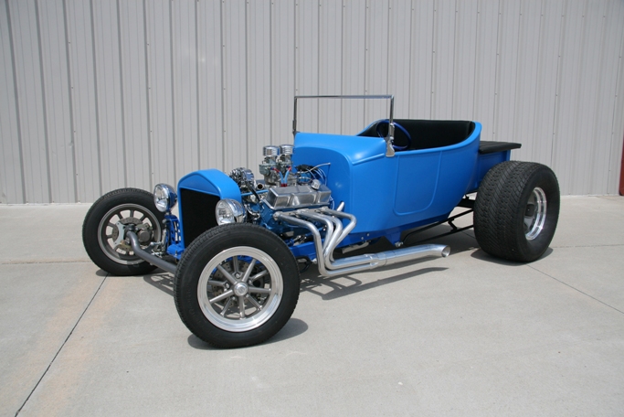

I love this Light Blue Speedway T-Bucket build. Does anyone have anymore information on it? I like the wheels and found them on Speedway's page, but unsure of tire size/brand or anything else, other than the SBC sittin in it? I'd really like to build one like this, but not through Speedway, LOL! Most likely through RPM.

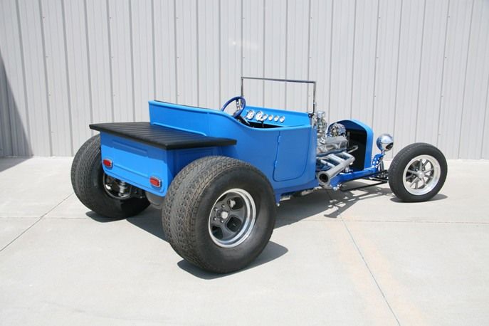

That's a cool ride. Looks like an unchanneled standard body with door (pass. side) and shorty (14") pickup bed. Also, Ford 9" rear with coil-overs and radius rods front and rear. I think that's a 10" or 12" windshield. Typical disc front/drum rear brakes. Rear tires look like big 31" x 18" Mickeys on 15" rims.
Thanks Spanky! I was curious about the rear tire size mostly. I did noticed it was unchanneled, which I actually like more than the channeled body. Now, I gotta see if RPM can get me into something like that!

Spanky - Rear tires look like big 31" x 18" Mickeys on 15" rims.
