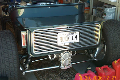

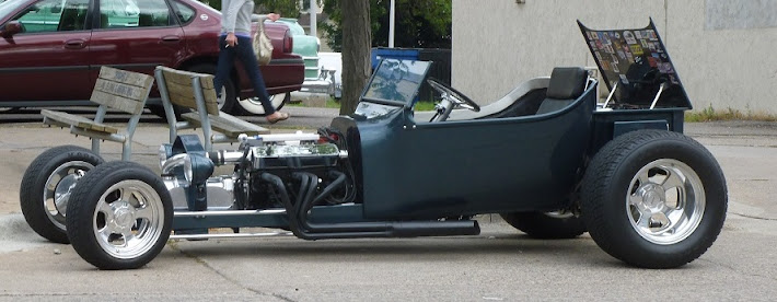

Here's what I did:
tl5fZi-NzhiRAEqDOeJSJH6ttUcpnrNmCo7pEZXnHKc=w710-h276-p-no
The lid is made of aluminum with a lip and hinged at rear with two hinges. A pair of Dakota Digital linear actuators open and close it. We bonded the hinges and actuator mounts so the lid is smooth on the outside. I stuck a bunch of show stickers on the underside.
lw6gnD0fQ77hVBxquM_QT4GuGgAxPcLnKX3Q9lm8vNM=w420-h278-p-no
The bed edge was already reinforced with 1/2" square tubing. And the lid has weather stripping to ensure a snug bounce-free fit when closed.
