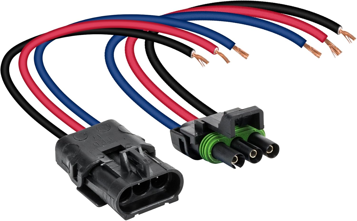

I used these on my bucket build since i will be racing it and driving it on the street. This way I can easily disconnect and remove the headlights when racing.
Not sure whats going on but i tried including the amazon link for the connectors. Here is a photo. They are listed on amazon as:
ONLINE LED STORE True MODS 3-Wire Weather Pack Connector Kit Assembled with 10" 12 AWG Wires
