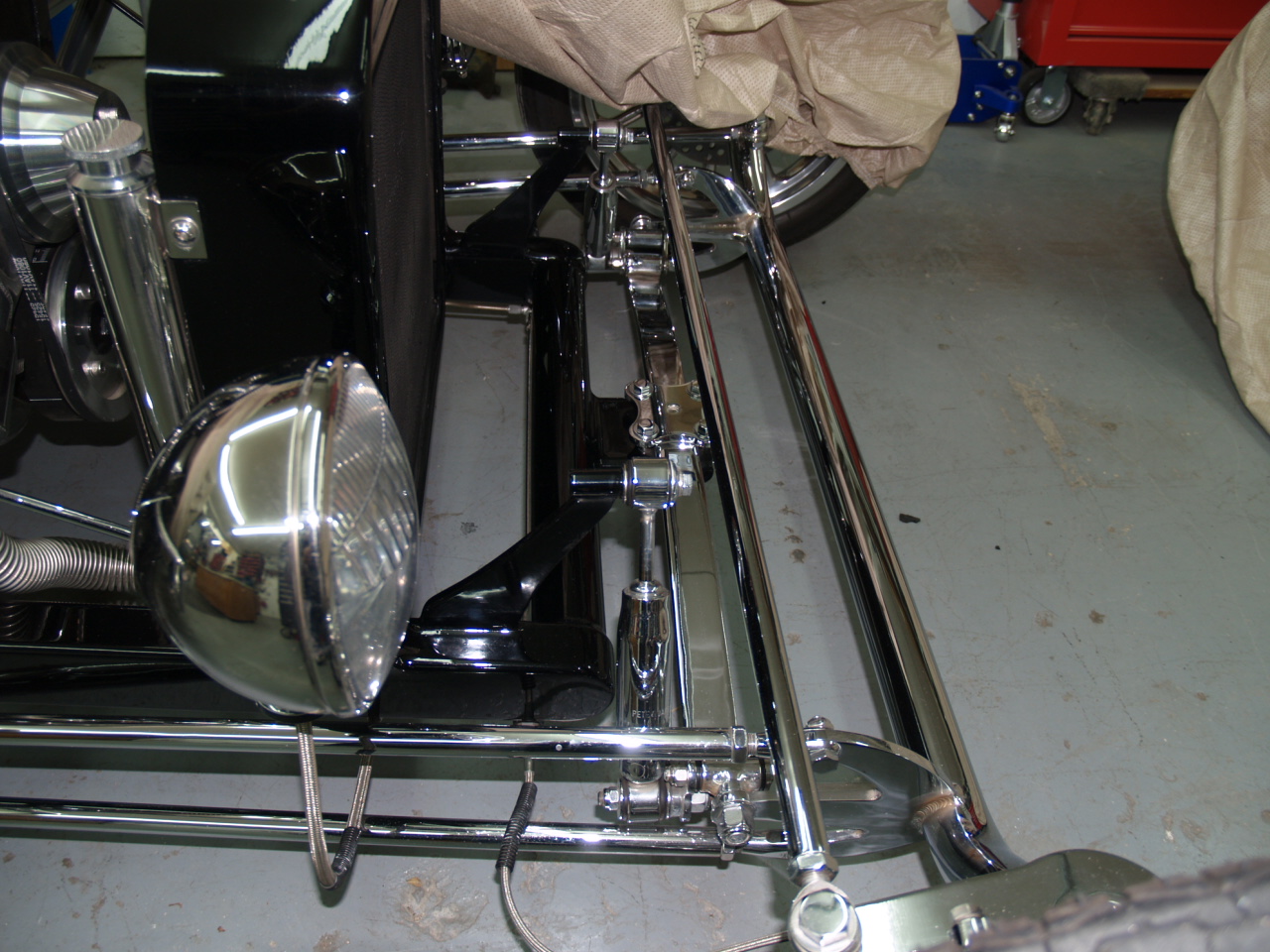

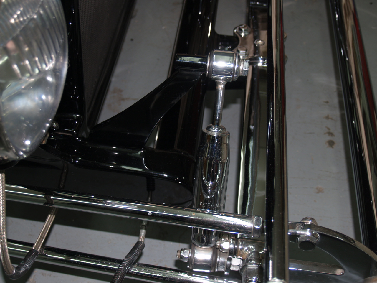

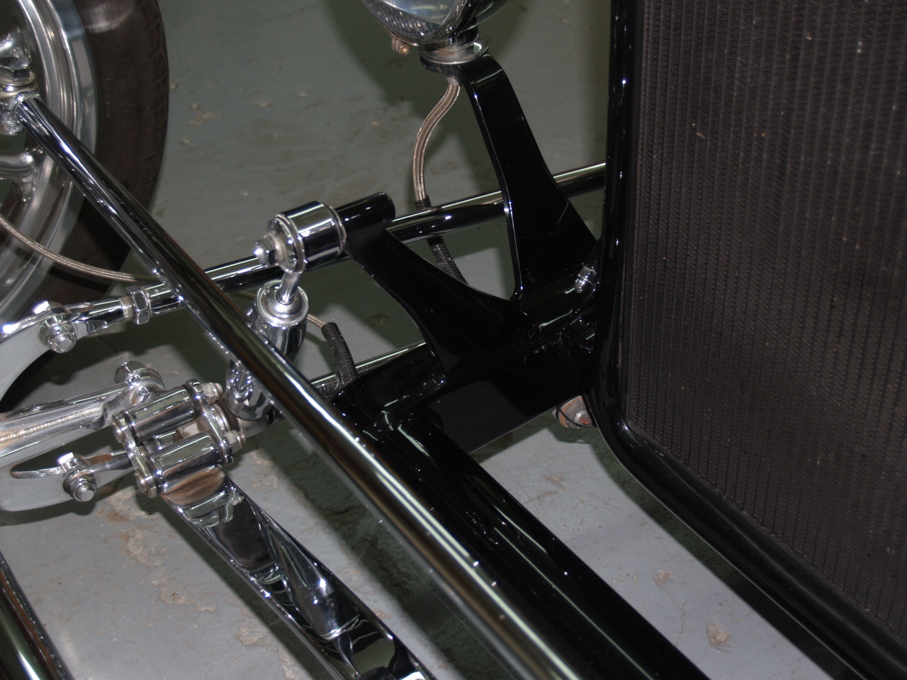

Here's some pics, I'll see what I can do about dimensions a little later this morning.

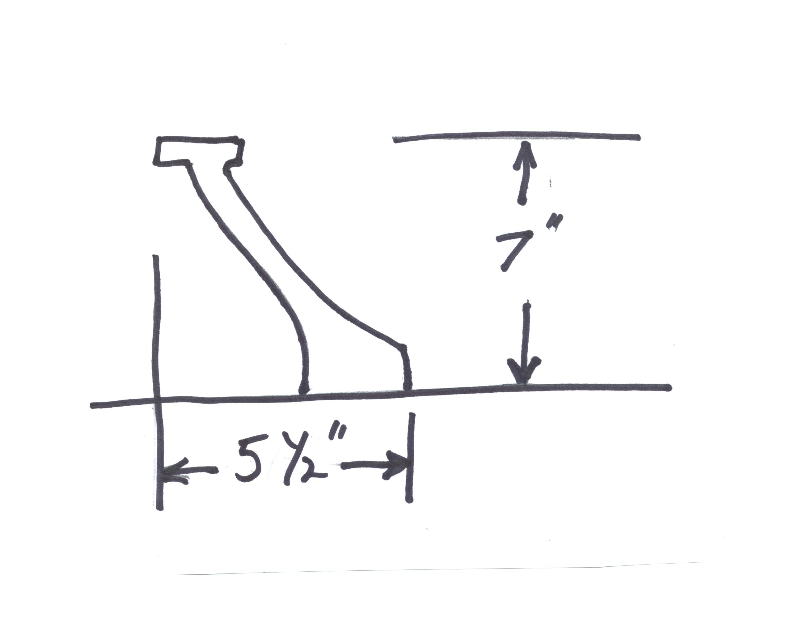

Here are some quick dimensions. No laughing at the manual CAD software.
