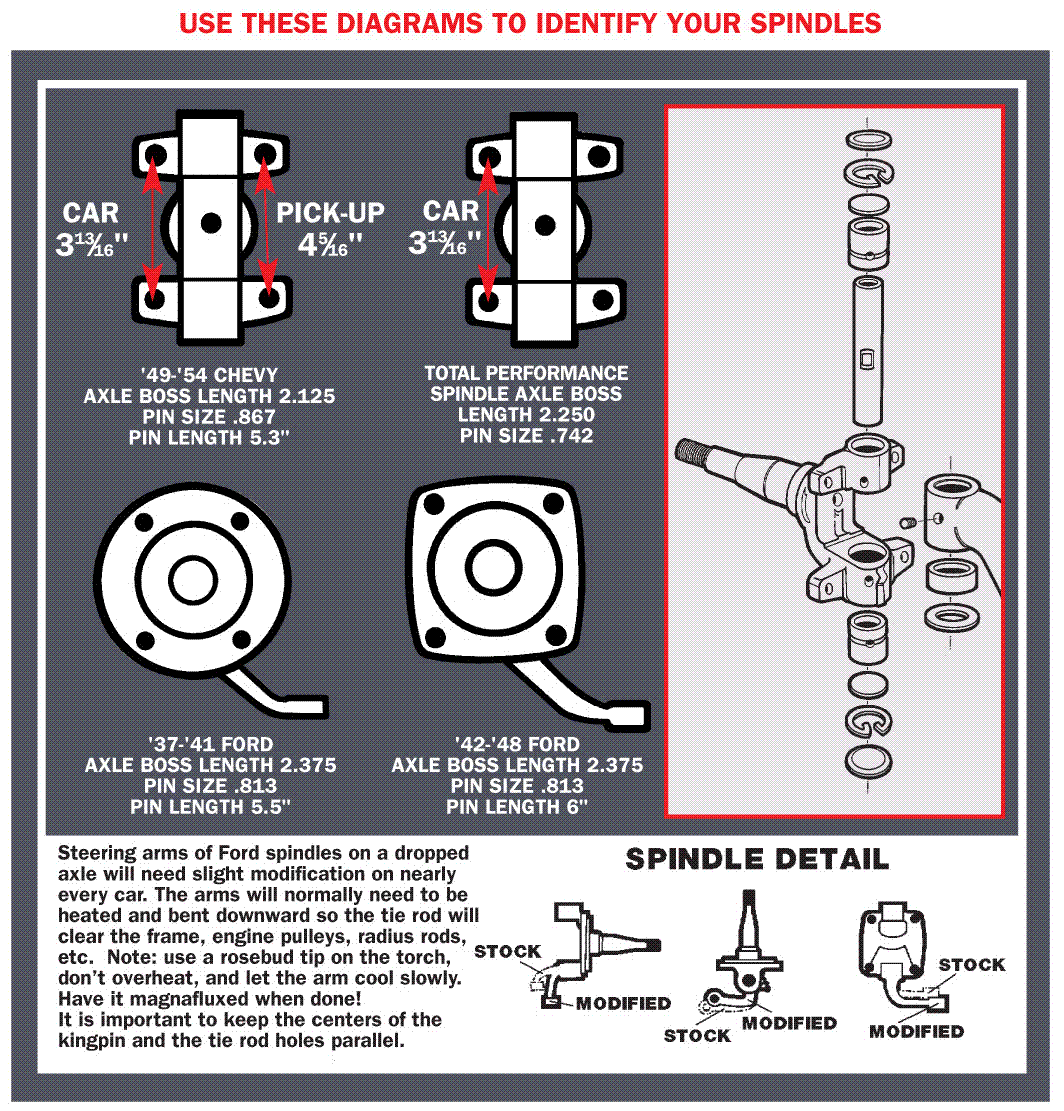

Let's see if this works....I'm going to try and share the pics using my Dropbox (shared) account as a URL link. Pics of the spindle. Anybody have a clue of what type of spindle this may be...year/make/model? I looked on Speedway Motors and the closest thing I'm seeing is the Mustang 2 style...however, the spindle king pin is still a little short of what I'm seeing in my measurements.
AACO-84TAiPdc4gnSicuDDmca
Looks like the "builder" put a thru bolt thru the upper and lower ball joints' bolt holes. I don't see any type of thrust bearings in there, and not for nothing, that weld(s) on the axle to the king pin housing is scary. IMHO I would think about getting a new axle and spindle.
I was wondering if this was a back yard experiment. The spindles are tight and free of any play...at least they got that right! :) :thumbsup:
