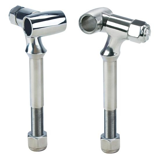

This is an example of the typical fixed spring perch

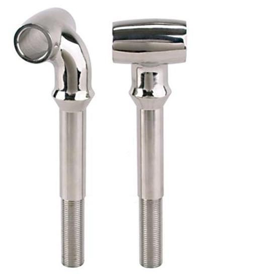

This is an adjustable perch
As the angle of the rest of the car changes in relation to the axle, the twisting effect on the spring is eliminated.
