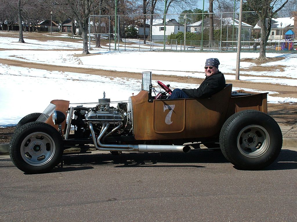

A slightly leaned back windshield makes a difference. Mine's 8" - 10" tall and vertical.
Yes that's SNOW on the ground. Iit's 98 degrees in Memphis right now and I wish it was cooler, so a chilly pic was in order... plus it shows my windshield so it's ON TOPIC!!! Yeah!
I'm diggin' the "patina" action!:lol:
Fred, that paint job cost me less than $25, including tax, the paint brushes, even the rattle can and tape I used for the 7 on the doors.
AND it's REAL rust, not a faux finish... painted on rust, but real rust.
Had it like this for a couple of years now and about ready for something different now that the wealthy street rodders are driving rusty cars also.
I should start sticking stickers all over it, wait... been done... dangit.
