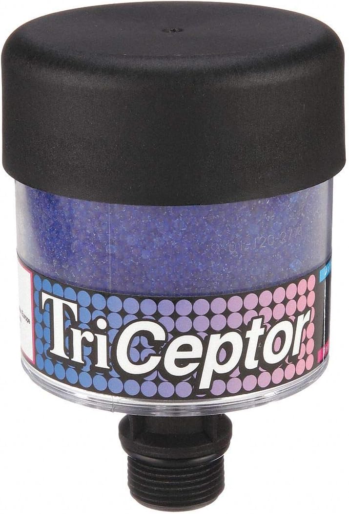

Assuming its condensation, I wonder if a modern desiccant breather filter on your tank vent would help?
Something like this on your tank vent might do the trick.
Its a little ugly but a stainless or polished aluminum cover shouldn't be too hard to fabricate. Or even just a painted fiberglass or plastic cover.
