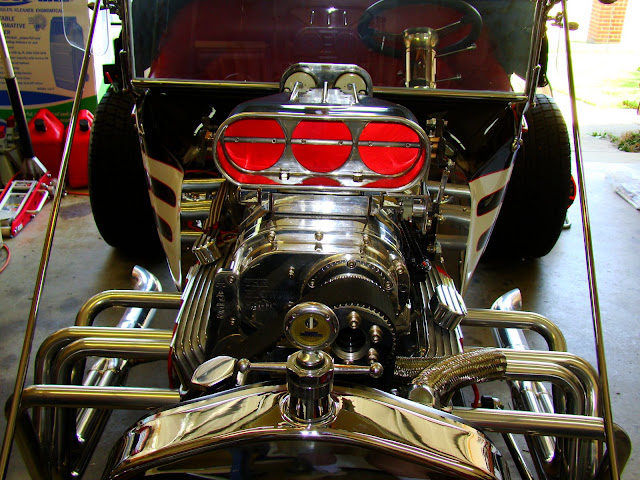

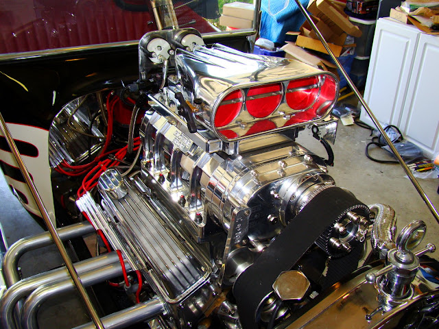

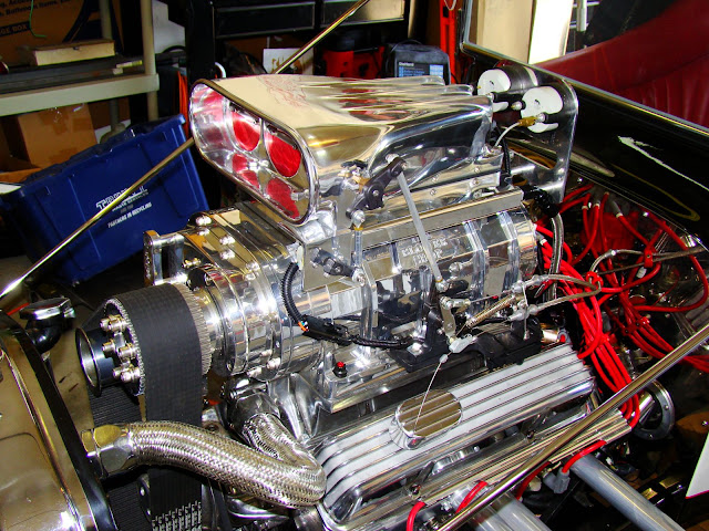

Okay, Here's a little teaser. I know its' dirty, I haven't cleaned it yet. This is what the EFI system looks like on the engine.

WOW
Thats So clean, its almost dirty
Gerry
That is a really cool looking setup.
Is there any provision for an air cleaner with that setup? That looks so neat that way.
No air cleaner, just running a screened gasket between the bugcatcher and the injector plate. If you wanted to go more traditional, you could mount the carb plate on top of the injector plate and run two 4150 throttle bodies, but that will cost you about $1500 more than this set-up. It's not inexpensive to do this and there is a learning curve to the tuning, but in the end I should be able to control the A\F Ratio and the VE at all RPM ranges including when it's in boost.

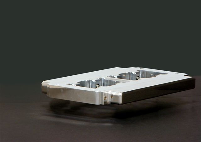

Mike, There is a plate between the bugcatcher and the blower that has 8 electronic fuel injectors in it. The plate is designed to conceal all the wiring to the injectors. It's made by a company called Autotrend EFI out in California.

That is a cool looking plate GT63. What kind of $$ did that plate set you back if you don't mind me asking? I checked the site but they have no prices.
The plate comes with the injectors and the harness. You could buy 9 Edelbrock 1405 carbs for what it cost for this plate. Like I said going EFI isn't cheap, but the tuning ability more than makes up for it.
There are less expensive EFI kits for non-blown engines. You just have to do your homework and find one that will work for you. There are a few good ECUs that are self tuning. FAST has a couple of nice units. You can get a good system for around $2000. A system like mine will cost you anywhere from $5K to $9K

Ahhh, now I see the plate. I put on a pair of sunglasses, to keep the glare down and I can now see details. :winkn: That looks like a pretty slick design on the plate. I'll check out their link.
It's the only plate I could find that had a clean look to it. The BDS, Kinsler, and Hilborn kits all use rails.
