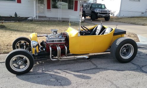

Welcome! Simplest way to avoid burned legs is just to re-route the exhaust. Either run it under the car like a traditional hotrod, or use a different type header that doesn't run under the door. Another option is heat shields that fit over the side pipes.

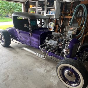

It’s home! Went and picked up my 1927 Ford T Buxket Roadster yesterday. It’s a Spirit Industries build from 2014.
Two doors, purple and ghost flies paint and a grey vinyl hardtop. 377 stroker engine with 3300 miles since the build.
We have been having major storms all month in Texas and yesterday was not different. We did Saran wrap from the doors up. Although it was flapping in the wind and rain at 70mph on the trailer , we made it home with a dry compartment and no paint scratches.
Nice 27 roadster! I don't consider 27s as " t-buckets" but they certainly qualify as model-T hotrods. Good score!

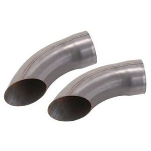

Quick solution to the leg-burn-on-exhaust problem: remove the long extensions and replace with shorty turnouts with baffles. That's my setup and it's not too loud unless I mash on the gas! :rolleyes:
