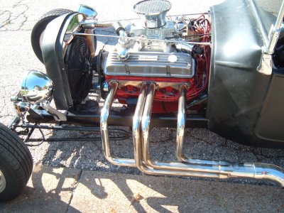

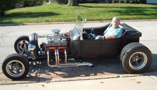

Mine is set up for SB Chevy V-8 and it's 32" from firewall to radiator. That said, I purposely wanted the engine tight to the firewall and close to the radiator, but I could have moved the radiator as much as 4" toward the front axle for more room.
PS - I channeled mine about 5" which limits my interior space, but . . .it's what I wanted.
Thanks so much, Spanky! I knew someone would come through for me. It may be me putting the cart before the horse, but I just wanted to know this info, before I made my next step, body wise. You’ve got a really nice looking ride, and you’re right….”It’s what I wanted”!
