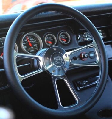

Do most people just buy Grant Steering Wheels and what size do you like to use? 15" seems a bit big. What do you all think?
