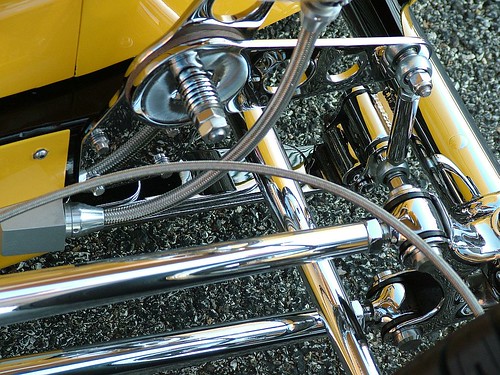

Does any one have any pictures of front 1/4 elliptical's where they mount to the axle via a shackle? I found some pics but couldn't see the actual shackle mounts. Thanks.

Maybe these shots will help you.
If you need further clarification, I'll take some more pictures in the morning and post them for you.

Thanks guys , awesome pics. However I am looking for pics of the same set up with a forged axle. I'm a bit confused about how to mount the shackles on a forged unit!

I'm sure I have more... but after searching through about 8000 pictures, this is what I've found so far.
Great pictures. The last three look almost exactly like my set up only prettier.

Jim, those last pics were taken at the 2008 NTBA Springfield Nats... it was a VERY clean Zipper's Roadster with a small turtle deck and track nose.
Super nice car (even thought I'm not a very big fan of Yellow for some reason), I took lots of pics of it... you just have to dig through all 2000 of my pics from Springfield to get to them.
