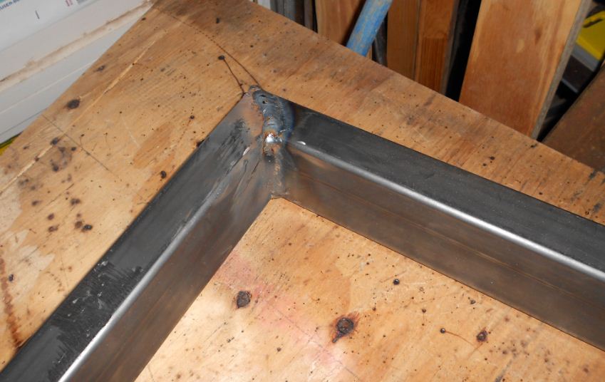

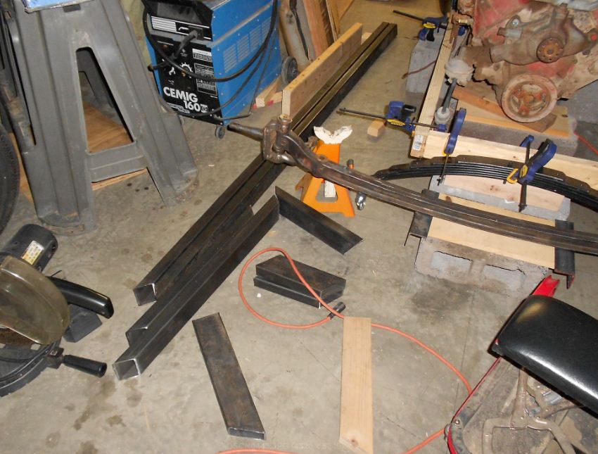

The rear stub is welded, the front is tacked, a have a 10 bolt and a chineese radiator.:)

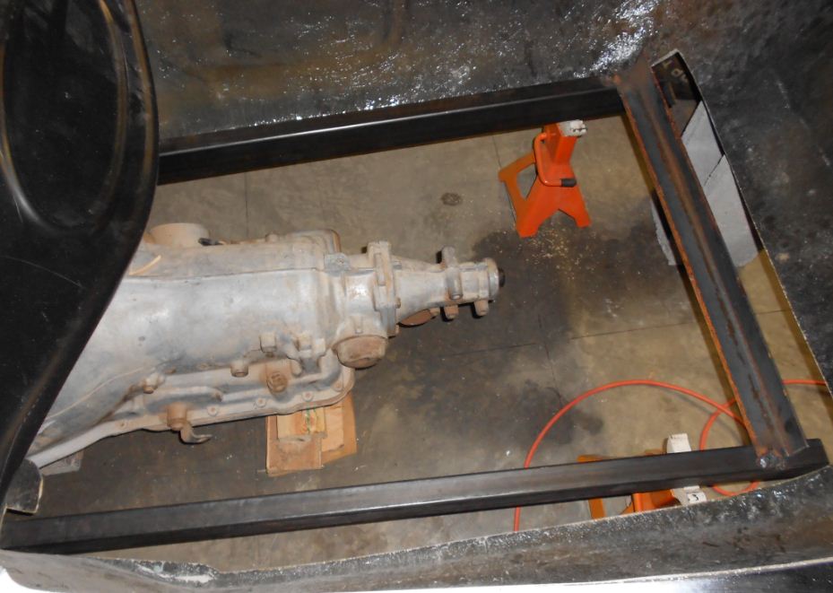

frame is welded, motor mounts are in, temp trans mount is in, starting on rear suspention this week.
