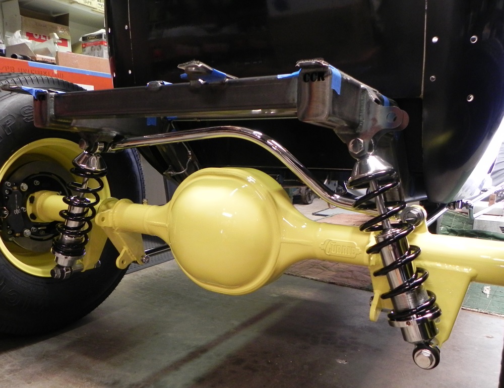

Your price list shows: #21609 Panard Bar Mount (welds by coil bracket on frame). But it doesn't list the bracket that mounts to the axle. Is there a part # for that bracket? Or am I missing it?
2 ?'s ...what are the rear -facing "ears" on the RR brkts. for ??.....Those springs "appear" to be very small wire dia. ,what's the spring rate ??
dave
The ears are for wheelie bars, they were added by the customer. he also had us do the 4-bar rear suspension instead of the radius rods, thinking he might need the wheelie bars for the blown Hemi his is running
Resinator, since I'm not using your upper coil spring bracket, will I need 2 of the frame brackets to sandwich the frame end of the panard bar? In the pics, it appears that a bolt runs through your coil spring bracket, then through the panard end and through the panard frame tab? Am I correct?
Thanks for the info. I appreciate the bolt offer! I'll post here before I order, but if I forget, I have a good source for Grade 8 stuff. And thanks for the pic. They help a lot.
