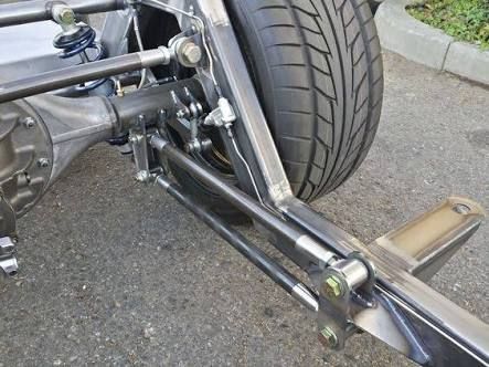

    Hello all,
    I've got the RPM rear 4 link kit. I've been doing lots of 4 link reading.. but I can't find much of anything on 4 link in a t bucket.
    Anyone got info they'd like to share or pictures of their setup?

    Not a lot of room under a bucket for 4 bars. Did Ron not send instructions?

    That's what I'm running into.. I need more frame kick up and lose the trunk idea.
    His ebay ad said something along the lines of "instructions not included. Must be installed by a professional"
    Well I'm a professional home builder lol. 3rd generation mechanic and my dad is a mechanical engineer. I'm no dummy. I just want to set it up properly to make the car hook.

    I worked for a month trying to fit triangulated 4 bar to no avail. Now I have decided on unequal length bars with a panhard bar. When I get my steering arms done I’ll move to the rear and have some pictures then.

    If you want to hook up, a properly set up 4 link is a better choice. If you put the top link outside the frame and use a watts link or diagonal between the bottom bar you don’t lose trunk space.
