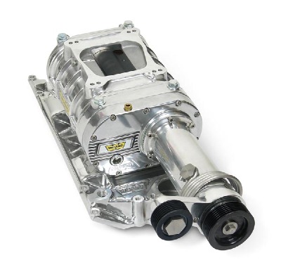

The little Weiand Blower used the spring tensioner
