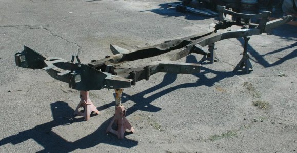

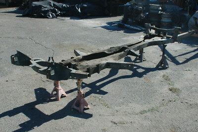

Another thought: with the 'backbone' style frame of the Spitfire you might need some sort of subframe to support the T body properly.
