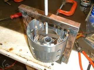

As for the specialized tools, I made some to use, they were not hard to create. I used to have a link around here that showed how to make the tools you will need, have to see if I can track it down.
700r4
Here is a link to how to rebuild one your self and pics of home made tools.
Here is his home made spring compressor.
