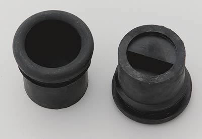

You could try some baffeled grommets like these.
Mr. Gasket 5425 - Mr. Gasket Baffled Breather Grommets - Overview - SummitRacing.com
Glad to hear your still around Fever.....I have the same problem with mine and thanks to GT's post maybe that will take care of it. I thought it was just me having the problem with blow by.
I had the same problem on the grommet on the PVC side. I took it out cleaned it real well and then ran a small bead of silicone around the groove and reseated it and gave it a 360 degree twist. Hasn't leaked a bit since. It also increased my manifold vacuum to 15inches.:run:

Update
Tried out the baffles from Summit and they seem to be doing the trick.
