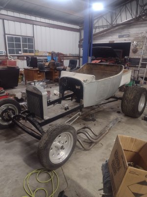

The front is pretty low in the mockup. You have the axle center at almost the same height as the front crossmember. Most end up with the crossmember being the same height as the spindles (center of the kingpins) or higher. That front spring will end up being flat, especially using a spring over setup. It can be done, but thought I'd mention it. Setup your drivetrain and accessories and make sure things fit how you want. 👍

As for the front axle I plan to buy a dropped I beam axle and run a reverse eye drop spring

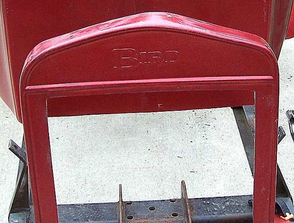

Judging from these articles, it didn't have the wings but did have the cowl lip.
You might try to ID the body before cutting. It might just be valuable enough to someone to cover a new one without.
I couldn't ID mine (busine4ss card inside is bleached white), but there are historians out there.
There is someone local to me selling the molds that are supposed to be the original bird molds, $3500 and they show to have the wings. I have seen a couple vintage adds with them as well but haven't put much effort into it

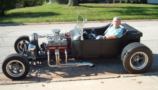

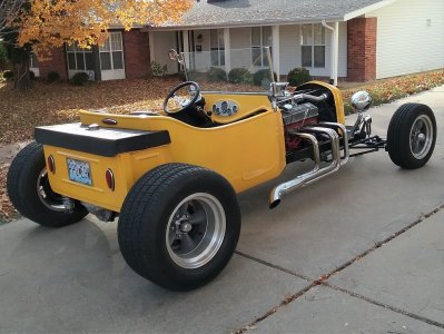

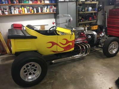

I installed the floor myself, because I wanted to channel the body over the frame. Then I had to put the seat flat on the floor so I could sit "in" the bucket, not "on" it. Not much leg room, but I'm a short guy.

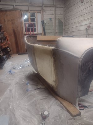

I'm still looking for a better body but in the meantime I thought I'd atleast attempt to fix this one. Made a copy of driver side and glassed it on. Not perfect but better than nothing. This is a great body to learn on, I can't make it any worse!

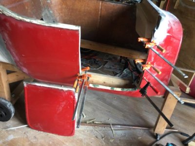

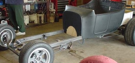

In my opinion...I would use what you have. I ended up cutting out my door and making it work. I'm sure you could make an door frame structure and glass the outside of it. Add a hinge and a door strap and you'll be good to go. Form it up and make it functional. Mine turned out ok.IMG_5671.jpg

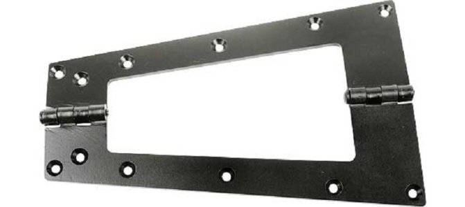

I've done alot of stuff to my tbucket. I didn't have a functional door on the drivers side. i purchased a door kit from RPM. I carefully cut around the door reveals on the drivers side of the body. I used the original body skin. I purchased a passenger side door kit. I removed the skin from the door kit ( from RPM). The body ( BIG BOY) was originally purchased from RPM . Therefore ; their door kit was a great fit. After removing the door skin from RPM's door kit , i cut the inner portion of the door into 5 pieces. I flipped the 5 inner pieces around & glassed them to the skin taken from the drivers side. Voila ! a very workable drivers door. I used original model t roadster door hinges to hang my door on the tbucket body.
