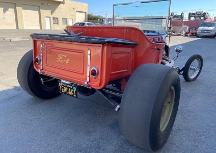

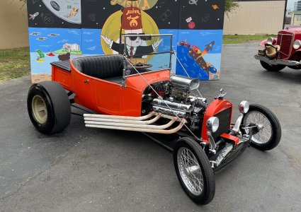

I've posted pics of my car before, but I still don't know much about it: I've been told it was a "magazine car back in the day," but you know how that goes! I've also been told this was built in the early-mid Sixties and that seems to hold up. I can't find any identifying marks on the body and I'd like to start there -- I can't find any business card under the fiberglass or any other name plates. Any guesses? Thanks all!

The details are what will help, for example is the dash original and different, the bed originally molded in or separate, and what length, cowl edge details, and the bottom edge of the body if it's still there.

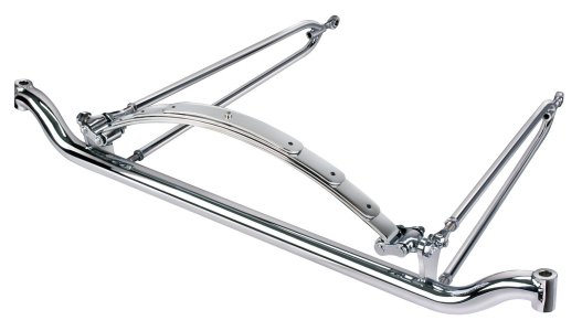

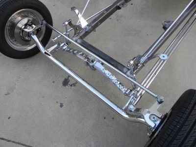

Especially when positioned 'spring over axle' rather than 'spring behind axle'.
This requires a higher perch on the front crossmember to allow the front of the frame to sit at the same height, all other things being the same.
One of those small details that make each T-Bucket unique.
