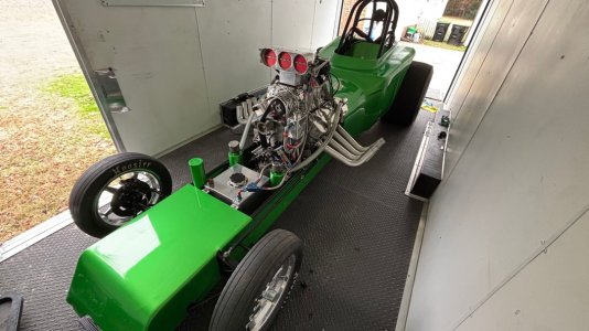

Here's a picture of Bryan's engine - eye candy!
