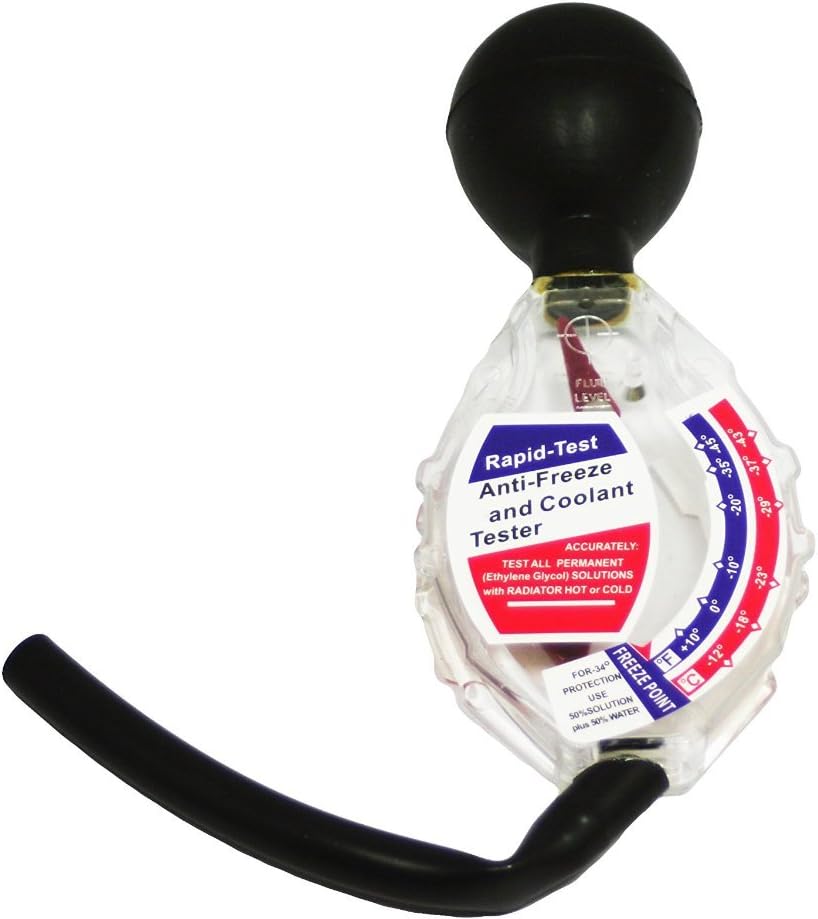

Depends on where you live too. In Texas I ran distilled water and Red Line Water Wetter. No antifreeze needed (did you know water is a better coolant than antifreeze?). Now that I'm in MN I run a mix of antifreeze and distilled water. And use one of those cheap gadgets to check the freeze point, like this one:
