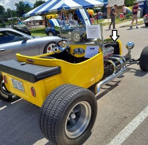

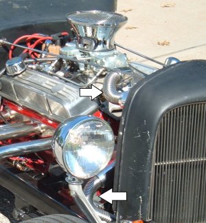

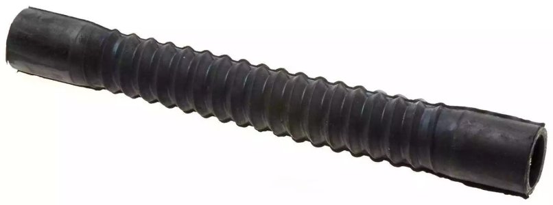

Had the same thing happen to my upper hose. It had the chrome cover like yours. I just replaced it with a rubber flex hose and keep on truckin'. Not as pretty but gets the job done.

I’m not a big fan of the flex hose. If you bend up a piece of welding rod in the shape of the hose, measure your hose end diameters where it attaches to water pump and radiator, bring that to the counter of a parts store on a NON busy day, usually someone will be kind enough to match it for you. Then I take that hose tag and stick it in my build log for reference.

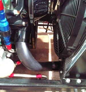

I'm running a Gates 21956 lower hose. It was plenty long on both ends and had to trim it to get it to fit right but the bend is perfect.
