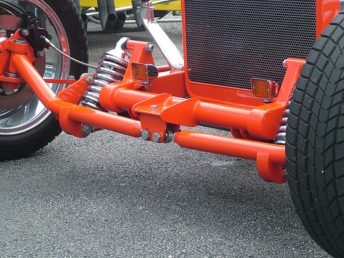

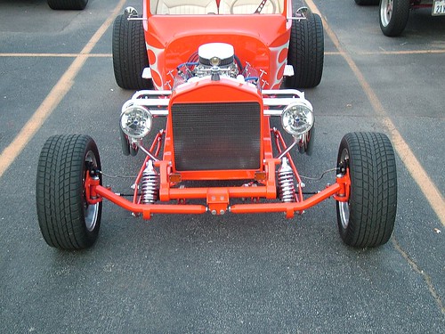

T Bucket IFS version
1. VW
2. Mustang II (or pinto)
3. Fatman Style (similar to Ford twin I- beam... similar, but different)
Not pictured, Actual Ford twin I beam (there are photos on hotroders.com) or Corvair IFS (like what Ben D had on his Pickup)
here I am trying to get the shot for you to enjoy... the things I do for yous guys...
Now the question... Is it worth it?
I've driven Dennis' car and it rides very nice. Al Carpenter liked the ride in his wife's car so much he changes HIS bucket to the same MII.
VW front ends can look a little bulky on the front of a T also. Ride any beter? don't know.
I've seen a few other style IFS buckets (a couple from back in the very early 70scoverage of NSRA Nats on Carnut.com. Some look VERY clean.
A good setup on tube or I Beam should ride as nice as a proper IFS setup. If you think it is what you want then GO for it. It can be done on the cheap.
It can be made to look clean, Once of the best I've ever seen was the Corvair Powered bucket I linked to last week sometime.
