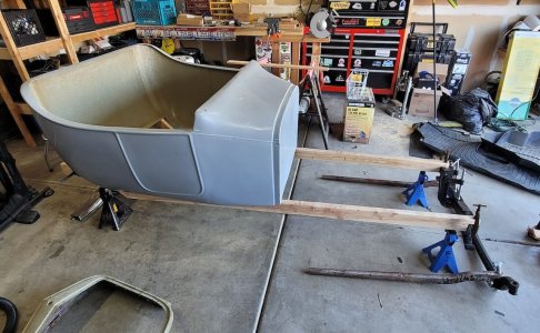

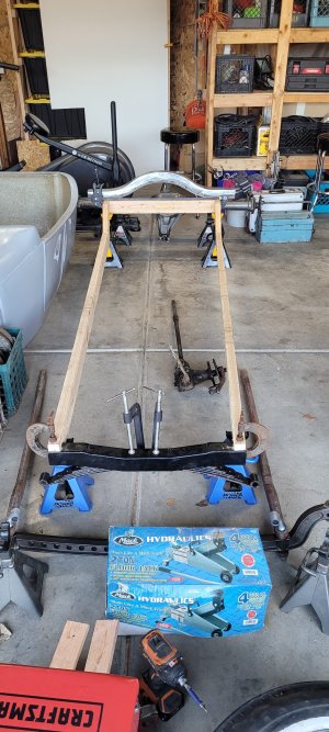

I spent the other weekend building a mock up frame from 2x4s following Chester's plans. This is just a starting point, I want the body down low so I am planning on z-ing the mock frame this weekend to get it lower.

You have the right place. Looking forward to your progress. Keep use informed and take lots of photos.
Great way to start. Getting the stance of your bucket figured out ahead of time is going to pay dividends.

Pasthisprime, I hear you loud and clear. Spent an hour tweaking up the wood frame this weekend before I pulled a muscle wrestling in a window ac unit. I'll get more this coming weekend.

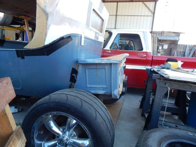

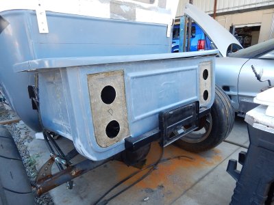

my bed was 20 inches long. I removed a 4 inch section so now it's 16 inches long. the bed houses a 10 gal. gas tank & a type 34 battery.
