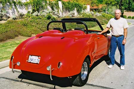

According to several sources, the use of a pickup bed allows the bucket to be registered as a truck and therefore a rear bumper would not be required. Since I am using a Model A rear crossmember, what I'm thinking here is to install a very basic wood pickup bed, temporarily bolted to the rear frame rails between the kick and the xmember. Once the car passes inspection, adios pickup unless it looks just too good...hmmm. I did a little bit of mickey mouse sketch, but I think you'll see where I'm going with this.

This is where I'm stuck. Never seen a bumper on a bucket, so if anyone has any ideas about something temporary I could rig up, I'd really appreciate your feedback.
