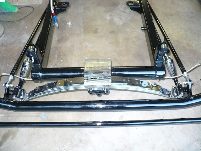

This isn't exactly what you're asking for, but I found these pics when I was planning my T.
It uses an I beam with fabricated bat wings that mount the spring behind the axle. Should get it pretty low that way. Looks like the spring in the pics might be a little short though. The shocks appear to mount off of a long shackle bolt.
Maybe someone on here knows whose bucket it is.
Just food for thought.
Mike

Thanks, Ron. I'll do that. That setup that Hotrod46 posted is so what I had in my head. I'd love to see what the rest of her looks like.

Fred,
I found this out with my front shocks. One, don't mount the frame mount to far from the shock. I've have to get a couple of long bolts to use for the bottom shock mount, with the shackles you showed, then had to make some some spacers to keep the shocks near vertical in the North/South (front/back) axis of the car. Just something I ran into.
Keep us posted Fred.
PaulR
