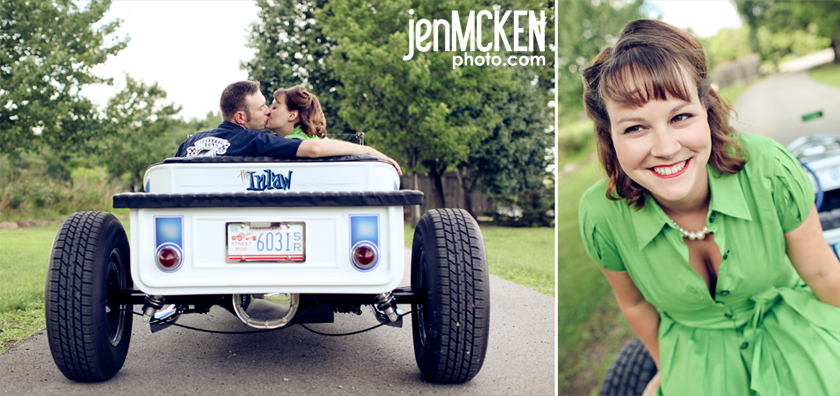

I would guess this to be a fairly fresh build, say 5years or so. Given that the rear is probably an S-10.
Looks like an s-10 rear, coilover shocks, front perch looks like the frame might ave been built with CCR plans, spring on top of perch, but the front end looks like a Speedway setup with the drag link in front of the axle.
Can't see the steering box location, so would be guessing on that.
Pontiac tail lights

It has a Pa. street rod license plate. I have a Pa. street rod plate on my t-bucket with much lower number. Mine was titled in 2006 , so the car in question was titled some time after 2006.
