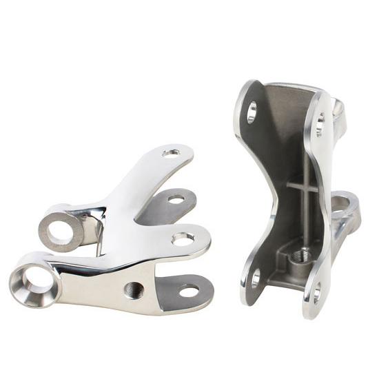

Check on your bat wings, there MIGHT be a threaded hole for your bar. You just have to weld a mount on your frame.
