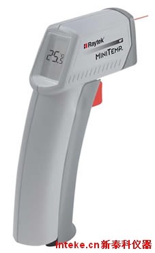

Try a raytek gun they are one of the best additions to a toolbox. They can find a miss quicker than any other way I know. Point anywhere instant temp. Best 40 bucks you can spend

Putz I may have to get me one of those and try that. I really hope it seems to be done now. It's been down since October and I have been going through withdrawls... :hyper: but i just decided to suck it up and replace the motor and get it done in the snow since I dont have a shop to do it in. :cold: so when everyone looked at me like I was crazy driving it this morning in 26 degree weather I just smiled...... :good:
