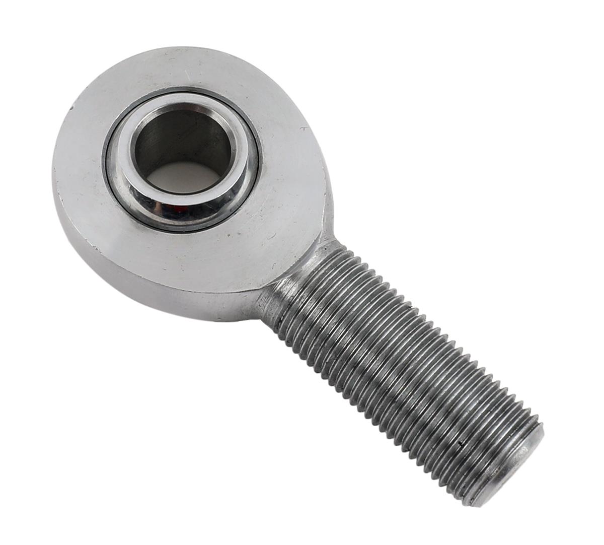

I used this series which would be much stronger than the ones you linked to made from Carbon Steel, the QA1 rod end are made from Chromoly Steel. They have a lining of made of PTFE and they are self lubricating.
For the ultimate in performance rod ends, look no further than QA1's XM Chromoly Steel Series male rod ends. These heavy duty rod ends are commonly used on 4-link and ladder bars for their strength and durability. XM Series rod ends are completely self-sealing and self-lubricating because of their Nylon/PTFE injection molded race that keeps dirt and debris out. The ball is made of 52100 bearing steel that has been heat treated, hard chrome plated and precision ground. The PTFE race is self-lubricating and self-sealing, and the body is made from heat treated chromoly steel that has a protective coating for corrosion resistance.
I don't like the idea of greasing a joint, unless it has seals to keep dirt out. The grease will get dirt particles in it and wear out the joint quicker. I always used the self lubricating plastic lined style that Indycars mentioned. No slop in those either which makes them perfect for steering. I remember buying the supposedly higher quality ones that Speedway offered to use in my steering and they had more slop than the old ones I wanted to replace!!! I still have them in my parts cabinet. The plastic lined ones have no slop at all and last for a LONG time.
