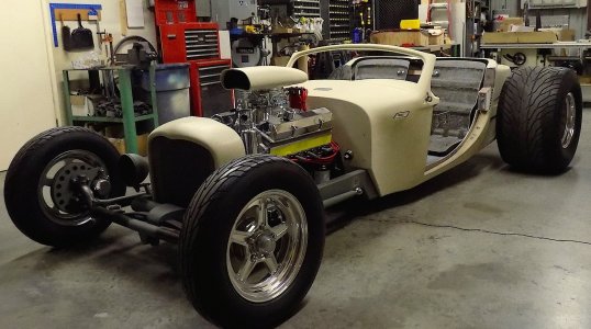

    The closest i ever came to what you are describing is when i modified a 32 ford fiberglass hood , to fit my 23 T project car. I made a skeleton out of pine wood. I cut out several ribs & pieced them together with horizontal ribs. I made some fiberglass sheets to skin the skeleton . I also incorporated many pieces of the 32 ford fiberglass hood. I used my firewall as a pattern for my largest rib , i used my track T nose as a pattern for my smallest rib. I connected the 2 ribs together with some horizontal ribs. I used 2 layers of 1 1/2 oz fiberglass mat to make my fiberglass sheets (for skinning my pine wood skeleton. To reiterate : this is the closest i have come to making an entire body.

    Here's some photos to help you better understand what i did: DSCN1460.JPG DSCN1461.JPG DSCN1462.JPG DSCN1463.JPG DSCN1464.JPG DSCN1465.JPG

    This photo shows more progress of my hood's fabrication : DSCN1482.JPG
