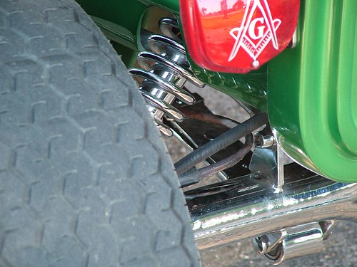

Pics
DSCF4243resized on Flickr - Photo Sharing!
There are a few more pics of Harvey's T there also.
I've got a few more on another one of my Flickr pages. Yellow lakester, gimme a few to locate those pics, I'm sitting outside the Route 66 Hotel in Springfield, IL right now at the T Bucket Nats.
