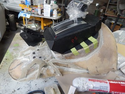

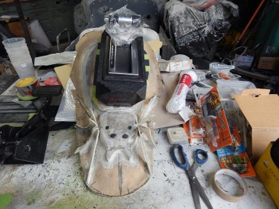

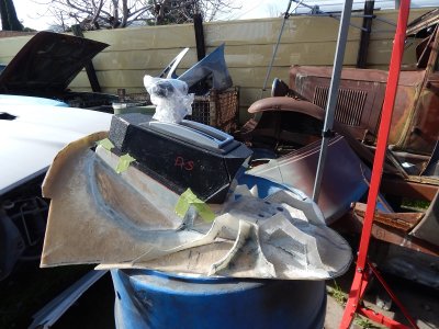

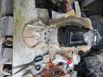

I began by making a thin skin out of one layer of 1 1/2 oz fiberglass mat. I also made a skeleton out of 1" thick pine . I layed the thin skin over the pine skeleton and applied clear silicone glue on several areas of the skeleton. I forced the thin skin around the pine skeleton framework & applied screws through the fiberglass skin above the areas i glued ( clear silicone glue). I left the freshly skinned skeleton framework overnight ( wanted the silicone to cure completely). The next morning i slowly removed all of the screws ( the silicone glue held on to the fiberglass skin ).After that i aglassed some coremat on top of the fiberglass skin. Once more i left it overnight to thoroughly set up. The next morning i glassed another layer of 1 1/2 oz fiberglass mat on top of the coremat. Again , this was left to cure overnight. Along the bottom outer edge , i screwed some 3" wide oak ( covered with aluminum hvac tape). I also screwed in 2 3" hvac covered oak on the bottom of the firewall section of the tranny tunnel ( these 2 pieces were basically vertical pieces. I glassed in 3 layers of 1 1/2 oz fiberglass mat on top of the 4 3" wide pieces of oak ( i was creating mounting lips)( or tabs) (for the tranny tunnel.).After this was done , i removed the 1" thick pine skeleton framework. I cut a hole on the top of the tranny tunnel ( center console) for the shift lever to fit through.
I’m going to put 1/2” foam sheets covered in packing tape so fiberglass won’t stick to it and lay glass over it. That will give me 1/2” air gap and that is all. I want it as small as possible. I’ll let you know how it works in a few days! It’s only a theory! Lol
The fiberglass tunnel has a rough exterior ( this is intentional ) ; The owner will carpet over it.
