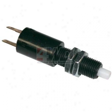

On my ''t'' the brake light switch is down on the floor, held by a right angle piece of steel with a round switch thru the piece of steel ,button being pushed in so there is no light,when you step on the brake, the button come out of the switch and the brake lights come on. I 'am working on another project and unable to find this kind of switch ??? Don't know where I got this switch.There is a lot of switchs that work just the opposite.

After starting with a pressure switch which failed in the first year, I switched (no pun) to this switch...
