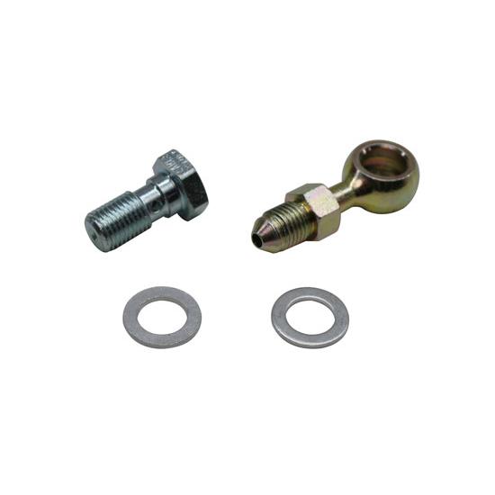

They have these banjo fittings for master cylinders in tight areas.
These are at speedway Enter master cylinder banjo fittings on google
The other place to get them from is Pure Choice Motorsports out of Lake Havasu, Arizona. They make them with a pipe thread so you could adapt to a standard automotive line instead of the AN version posted. If I remember they are a little pricy, but the brakes are not the place to go Cheap!
