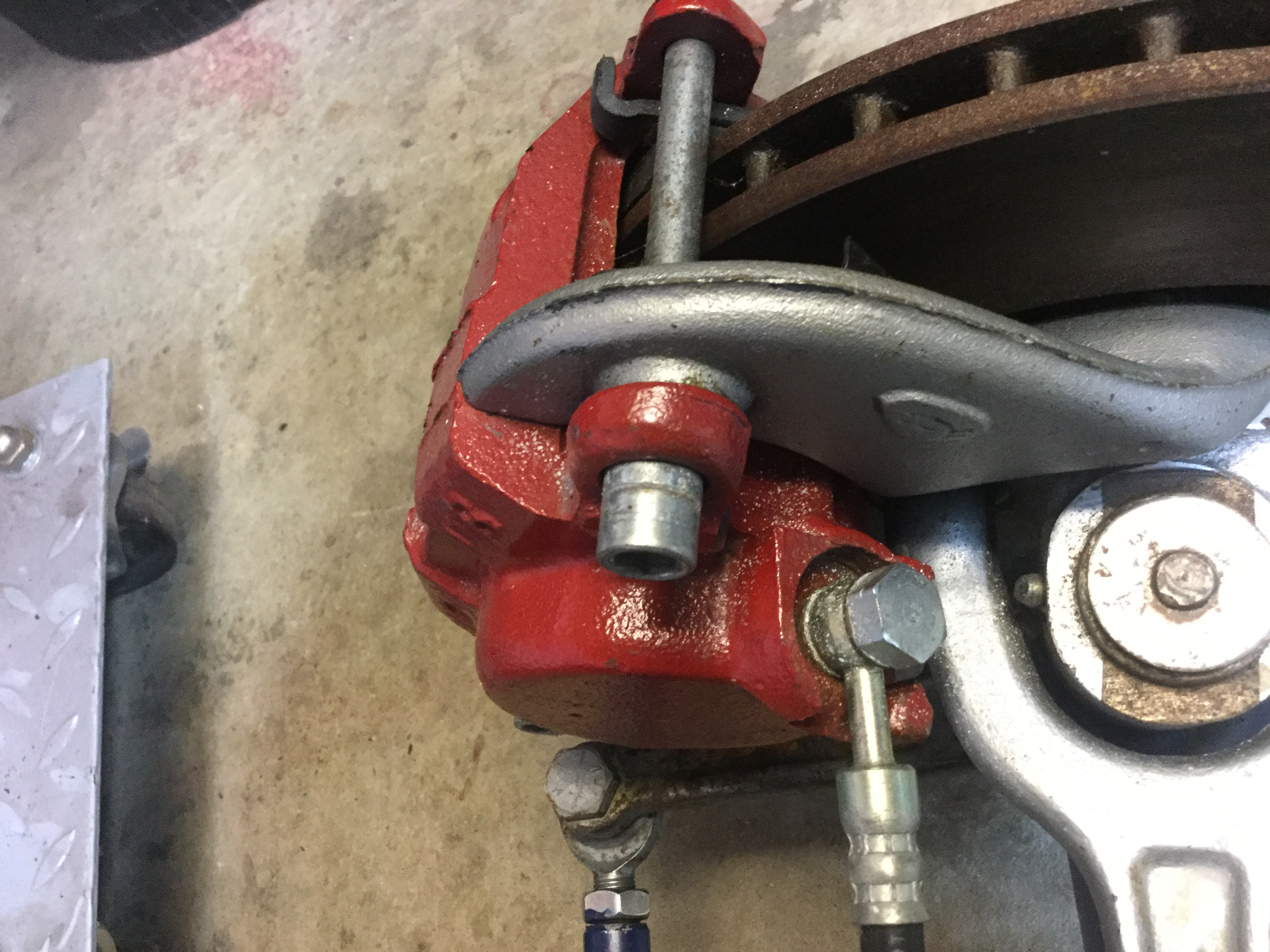

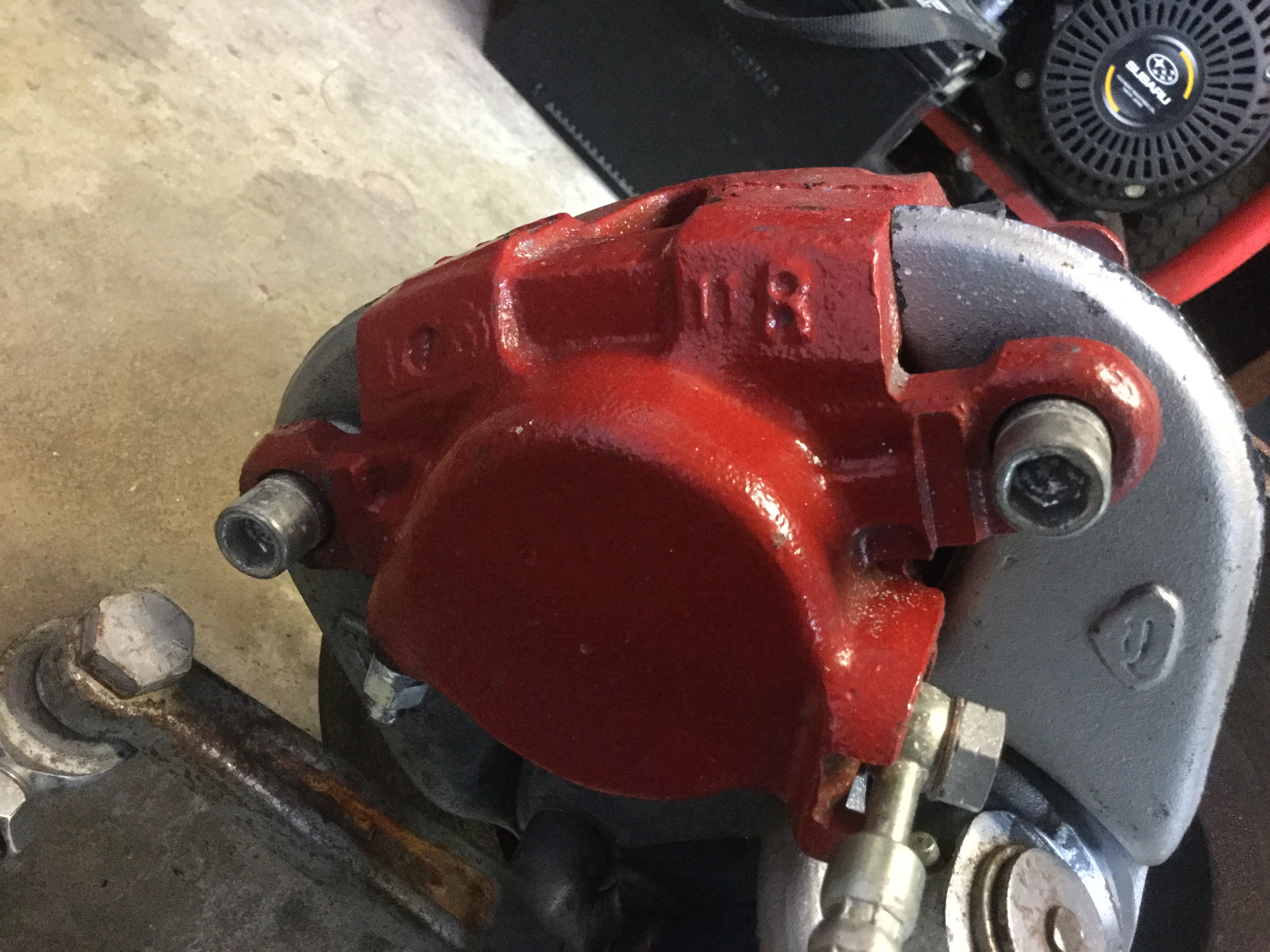

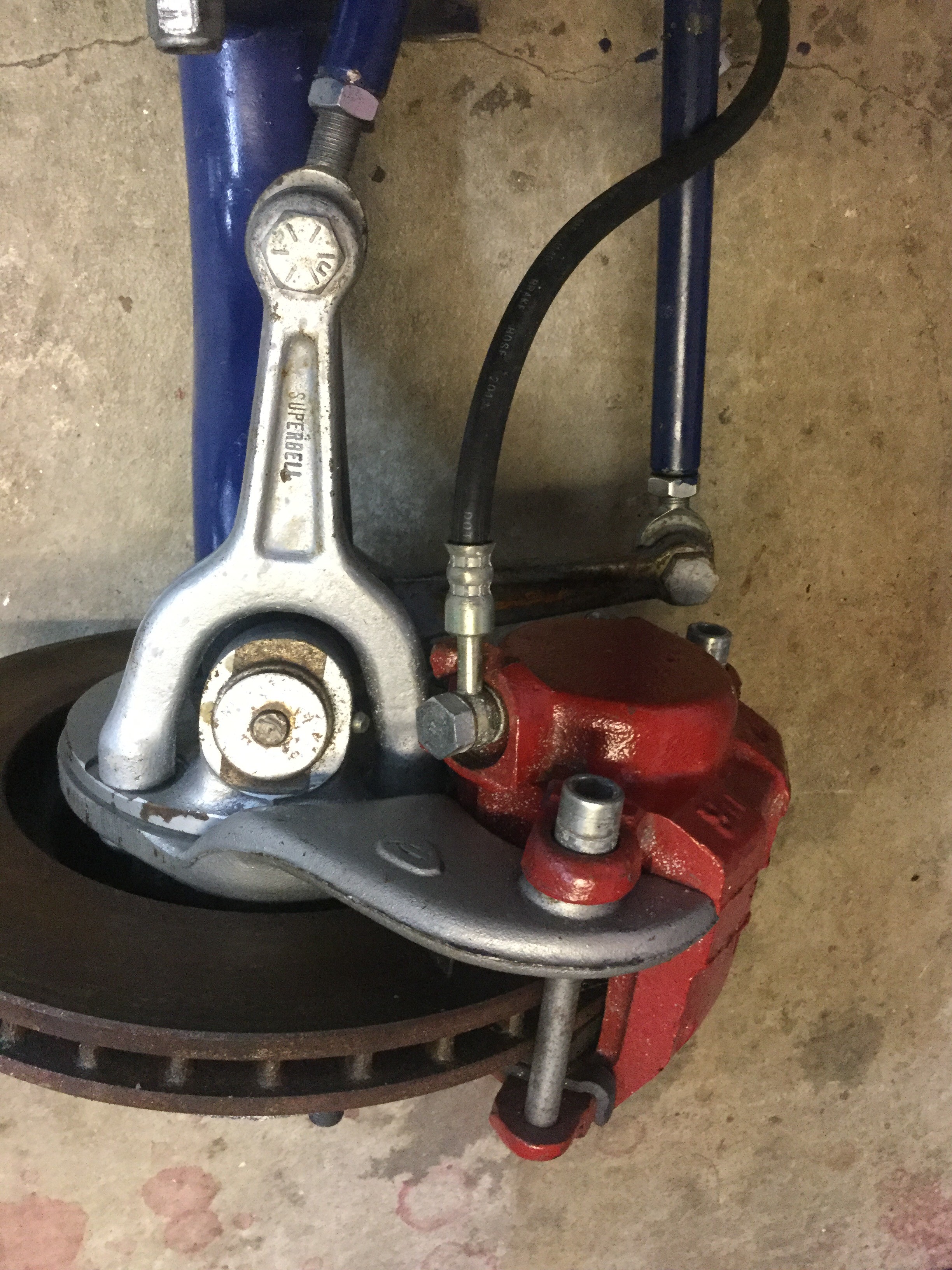

Help me identify these front calipers
On the new project I picked up, the front axle has these calipers on them and wondering if anyone can identify them for future pad replacement and any service issues that may arise...
Here are a few pics
Thanks in advance!!
HRTT
Yup. Big "S" logo looks like Superbell. Might send them a email for info.
If it were mine I would think about getting a longer tie rod it looks like that rod end does not have a lot of thread in the tie rod.
Nothing is adjusted, the other end of the tie rod shows no threads.. but thanks for your observation!!! Good eye!
I have a hybrid set up as well on my front.
Rotors - 78-85 Dodge Diplomat (5x4.5)
Calipers, Pads, - GM 78-87 Chevy Caprice
