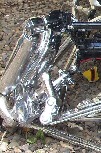

These failures of really top quality builds really freak me out:.
. I'm still waiting to hear what actually happened on this accident, but first report was of a failure in the front end that invited a sudden "exit... stage left" for the driver (who survived with only a broken leg).I trust my welds and fabricating skills...... but I guess some self doubt can be a healthy thing to..maybe I WILL change those clevis over to rod ends on my hairpins. the binding action in this type of construction HAS been in the back of my mind all along on my N* T project.

Great idea. I have always been suspicious of clevis mounts. I have used spherical bearings throughout the Fads construction and in DOUBLE shear everywhere. There is one place where I have been forced to use single shear but it is bothering me and I wil find a way to change it. Every spherical I have used is held in place with a pin. The head of the pin is bigger than the spherical housing so if the bearing fails the part is still capitvated by the pin head.

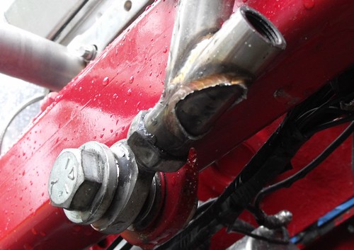

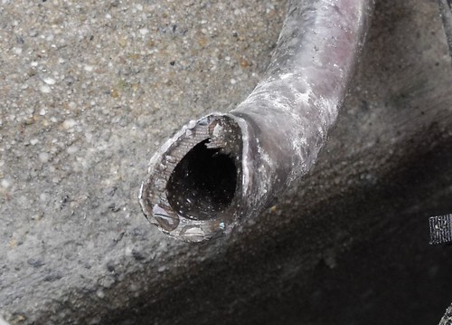

I think these were Speedway Stainless radius rods.
That doesn't look like very good penetration to me.
My guess is that hair pin broke on impact after the axle broke. I don't think there is that much stress on that hair pin.
Goes to remind everyone that a good looking weld is not always a SAFE weld. These pics give me the willies! After seing some of these failures, I'm sure glad that we're the ones building our own 4 bars, hairpins and brackets. Just got 50' of 1" DOM seamless tube today for the hairpins on our new bucket build. We'll definitely be focusing on some goooooood penetration of our welds!
RON, I SURE AM HOPING THAT YOU ARE NOT MEANING THAT RADIUS ROD WAS CORRECT IN ANY WAY..?? THAT IS A FUSION WELD ONLY, THE RODS WERE NOT V CUT AT ALL, AND YES THEY ARE UNDER A TON OF STRESS, ALL THE TIME... I HAVE SEEN WAY TOO MANY OF THIS VERY SAME THING HAPPEN, AT THE VERY LEAST A CENTER CONNECTOR SUPPORT WILL HELP LESSEN THE STRESS FACTOR, BUT ALL WELDS NEED TO BE A FULL WELD ALL THE WAY THROUGH THE SEAM CONNECTION... WHEN WELDED CORRECTLY, THE WELD IS NOW THE STRONGEST PART... THIS IS ANOTHER REASON TO RUN THE HECK OUT OF YOUR CAR, ON BACK ROADS TO SEE IF IT HANGS TOGETHER, ESPECIALLY IF YOU DO NOT KNOW WHAT THE WELDS ARE REALLY LIKE... RIDE SAFE, TEST AND TEST SOME MORE BEFORE GETTING OUT ON A BUSY ROAD... THAT TYPE OF WELDING WILL & CAN KILL YOU AND OTHER'S AS WELL... :(
THE POINT I WAS MAKING WAS NOT ABOUT THE QUALITY OF THE WELD. BUT WHICH BROKE FIRST THE AXLE OR THE HAIR PIN?
