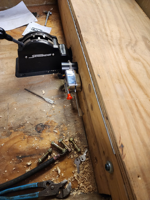

    It now steers! Finished up the steering column and all connections. Started on the brake placement. Pedal hits the column. I think I'm going to cut the pedal down some and hope I don't miss the extra pedal pressure. If I move it back the master goes under the trans crossmember and I won't be able to remove the lid
    Ideas?

    Move the pedal to the right. Just heat and bend for clearance. Or a small notch in the pad.

    Yeah, I've got to set my gas pedal first then I was thinking bend the pedal and cut the footpad and I should be good.

    I cut my pedal arm off its mount below the floor board and welded in a section of steel that spaced the arm sideways about an inch or so. The welds below the floor board don't show and kept me from having to re-chrome.

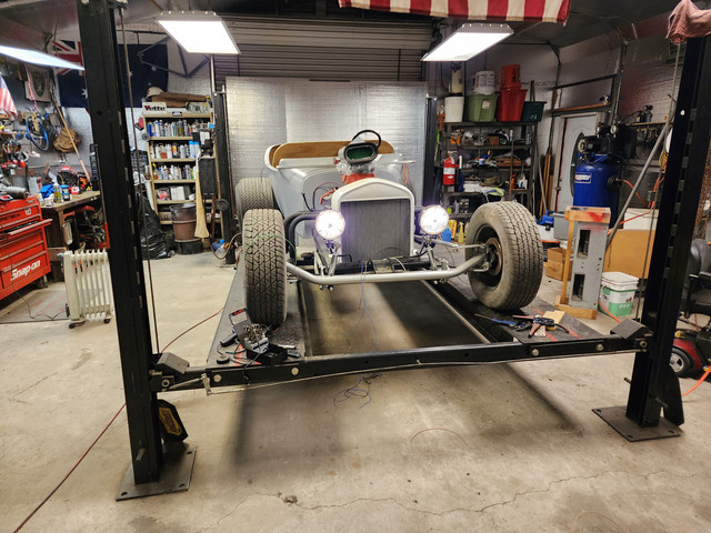

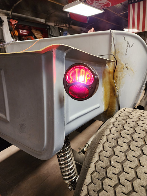

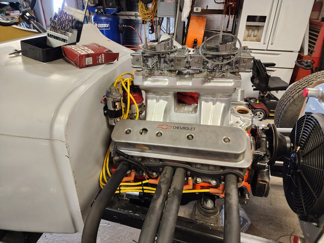

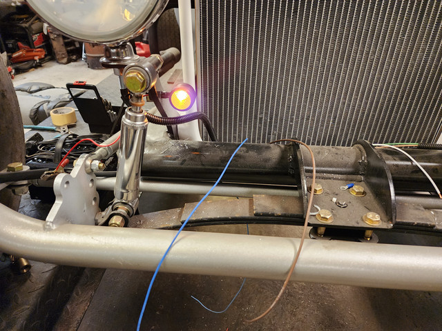

    Been a while fellas. I'm still here and building. I had some rough stuff go on in my personal life and shop time wasn't happening. I've got the wiring 80% done, engine assembled and primed, working headlights, taillights brake lights, blinkers. Gotta put the fuel line in and then gonna start it for some motivation. Need to plumb brake lines.
    All of my pics are to big to upload so I'll put them on another site an Post them from there
