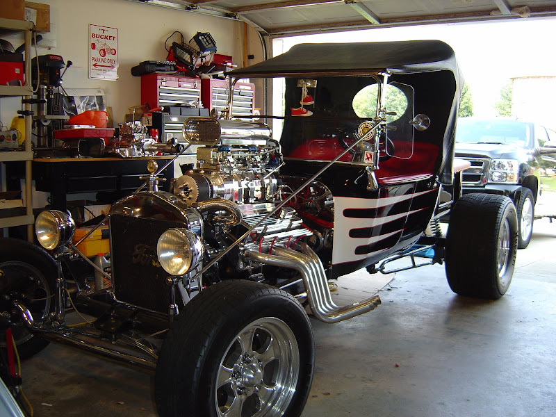

Finally got my 6-71 installed and the engine running. I'll post photos later. It idles good and starts right up, but how do I get rid of the blower surge or do I want to? It seems to like the timing around 16 degrees.

OK, here's the scoop. It's a 350 SBC bored .030 over. It's a 010 block with 4 bolt mains using ARP studs. The crank is forged steel. The Rods are GM performance LT1 rods that have been pinked(sp). The pistons and rings are a match set of Keith Black forged blower pistons with -18cc dish. The heads are Edelbrock performer RPM aluminim heads with 70cc chambers, 2.021.60 ss valves, and roller rockers from Crane. The cam is a Comp Cams 268AH-14 with a 114 lobe center. The blower is a NEW 6-71 from The Blower Shop. The top pulley is a 59 and the bottom is a 48. It uses an 8MM belt. The carbs are those new BG Road Demon Jr inline blower carbs with 625CFM. Ignition is MSD 6al and MSD billet distributor with a Mallory coil. I'm using a Holley Red electric fuel pump.
Here's a link to my Picaso gallery.
http://picasaweb.google.com/gtolbert63/Blower_installed
I had to do alot of trail and error to get the fuel line plumbed since the fuel ports are on the driver's side.
Looks great GT. Anxious to hear how it runs compared to the 142.
