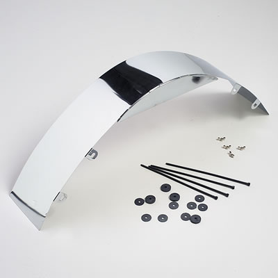

Thanks for the info, so with the thermostatic switch I would not have to make a jumper wire that Rooster used? The other link shows how to wire it correctly. Has anyone made thier own shrouds?
Mike
[quote name='50's Kid' timestamp='1312737831' post='137541']
Mike
[/quote]
I had one of these probably real easy to make out of aluminum or stainless works great.
