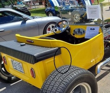

When it came time for me to attach the fiberglass pickup bed to my 23 body I decided to simply bolt it to the rear of my body & use fender washers for strength. I have seen so many PU beds that develop cracks in the area where they join to the body and I wanted to avoid that. I don't think mine looks too bad and it saved me a lot of work. What do you think?
