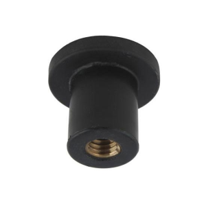

How is your T-bucket body attached to your frame? I used the well nuts that are supplied by Speedway, but I know some don't like this method.

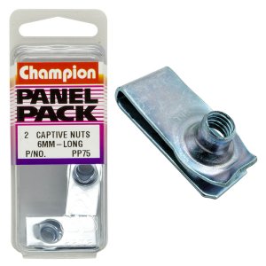

Mine is an old school channel frame that's been boxed front and rear. The center under the floor is still a channel so I used captive nuts, like these.
