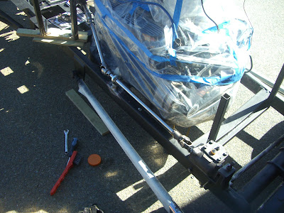

Hey there all,
I finally got some time to work on the Bucket.
I actually made some really good progress and got my steering 95% sorted.
Im so happy with the final result, its been a long time getting to this point.

Very nice work. I only noticed on small detail and i am a bit hesitate to even mention it but here goes . ITS ON THE WRONG SIDE. And i think you distributor is also in the front. This can only mean one thing you will have to drive backwards on the wrong side of the road. :wacky: :zingy:

At first I had typed that exact thing about it being on the wrong side but then I realized that he must have photo-chopped the picture and reversed it, by mistake.

Wow, 4140 steering shafts? I'm impressed.
I'll need to use a Double D at my rack but will use spines the rest of the way up.
I've been of the opinion that Double D shafts and u joints aren't as tight as splined joints and allow a tad of steering play? Is that the case or are Double D's just as tight?

I have double D's on my T and splined on my '37 and both are equally tight with absolutely no play.
