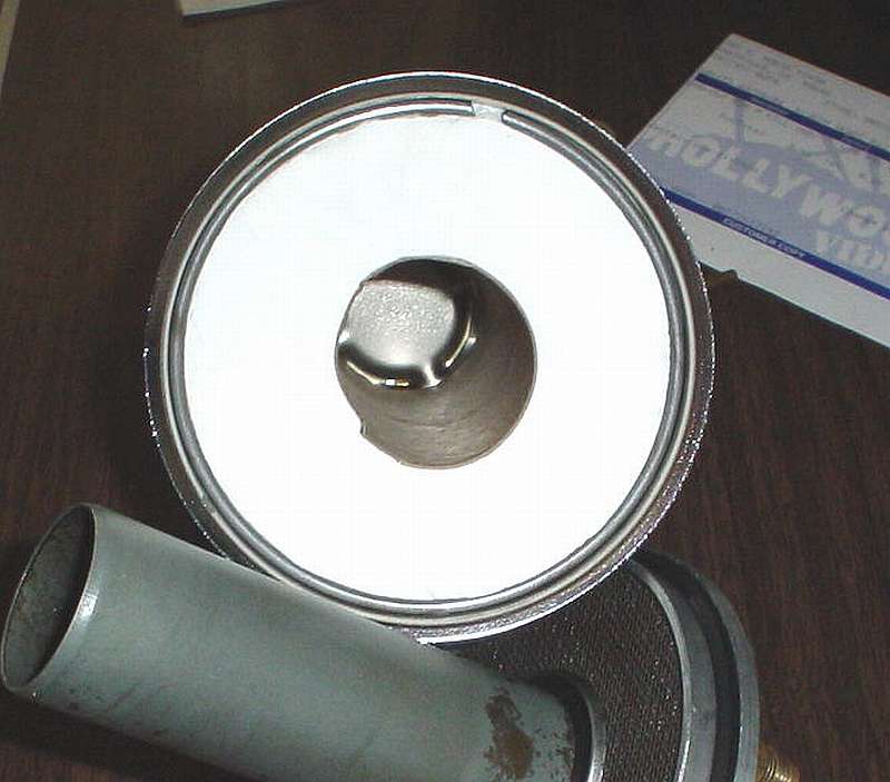

That isn't cheesy the old toilet paper filter was really cheesy.These where in bypass probably from the start.
