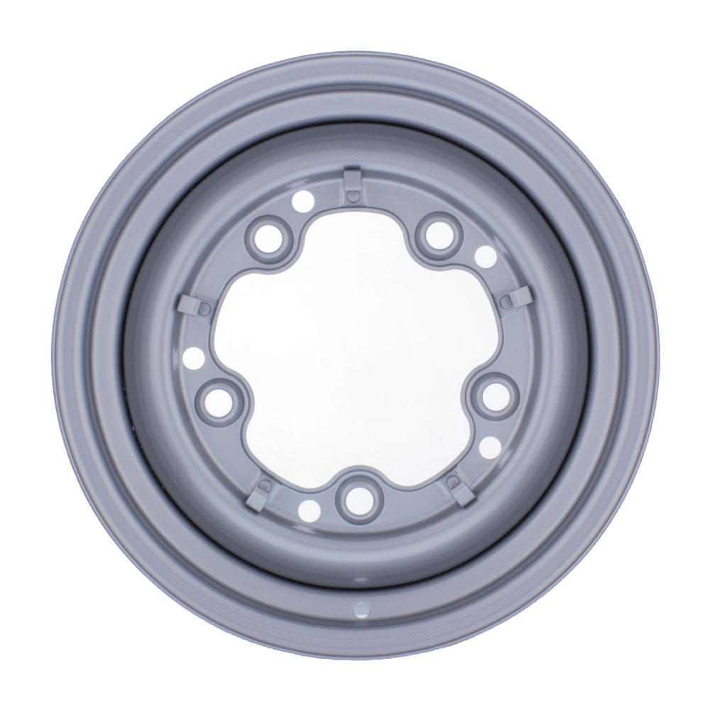

I've been looking on ebay as well and can find 5" but would prefer 4 or 4.5" The VW wheels would not require the lug nuts to be recessed into the adapter. The adapter would be creating a wheel center for the rim. Below is a photo of the VW wheel. The bolt pattern is roughly 5 on 8.07"

The adapter plate will be a round circle with a set of holes 5 on 8" to bolt the vw rim too. Closer to the middle will be a set of holes 5 on 5.5". There will also be a hole in the center for the hub. The vw wheel will bolt to the adapter plate with 1/2 bolts. Then the whole assembly will bolt onto the car like a regular wheel.
Similar to these EMPI VW 5x205 Wheel to Porsche 5x130 Hub Wheel Adapters - Pair - 9481

I can see the idea of using VW wheels as for the big center hole if you're adapting.

I have no idea what you are looking for due to my limited knowledge of wheels but the wheel in the picture looks a lot like the ones they use to move mobile homes with, if this is any help.
I thought they were VW WHEELS. Don’t know the bolt circle but some early Ford wheels had the wide 5 bolt pattern like ‘35 -40 ish maybe.
Yup these are VW wheels that I posted a photo of and unfortunately they are a different bolt pattern than the old Ford wide 5s. I went to the junkyard today and found a decent set of those VW wheels but i didn't realize how large the bolt holes are so i passed on trying to make the adapter. Didn't have any luck finding any 15x5 wheels either. All the spare donut wheels were smaller bolt patterns. I will keep my eyes out at car shows or maybe i iwll seel these tires and get some for 16" wheels which are easier to find
