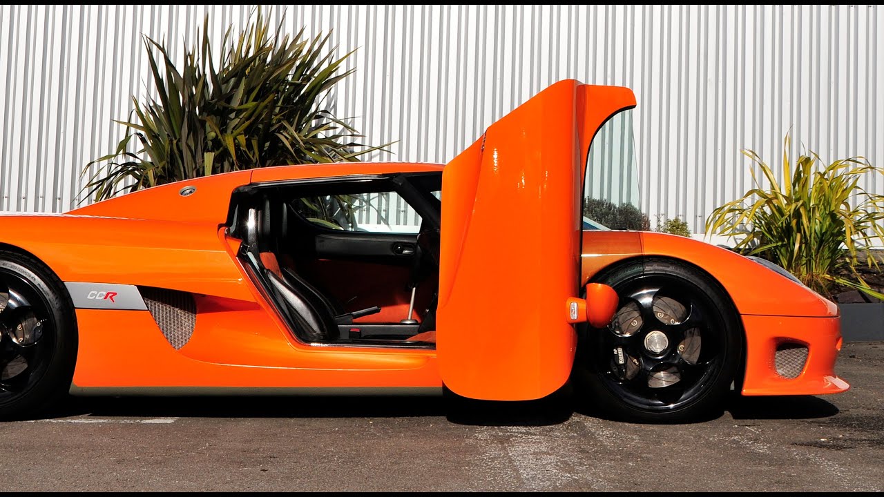

My dream door would operate like the Koenigsegg hyper and mega cars. They do not raise up like the BMW above, and they do not swing out like conventional doors. When the doors are unlatched, they slide out until the door clears the side of the car. Once clear the door rotates around a pivot point near the lower front corner of the door. The whole motion opperates with no more than finger tip pressure, and the door does not become a sail up in the air.

@Zandoz, check this out.
Cool, but that door sill raises as it rotates up. The raising requires more power...mechanical or human...and subjects the hinge and it's support to more stress in situations like a windy day. Also, they tend to leave a substantial duck-under obstruction. Unfortunately like so many of the Koenigsegg innovations, they are internationally patented and not likely to appear on anything other than their ultra expensive and ultra low production cars. Generally their cars make the Bugatti Veyron look mass production. There will only be 6 of their mega-car One:1s built, with a price tag of between 2 and 3 million.
